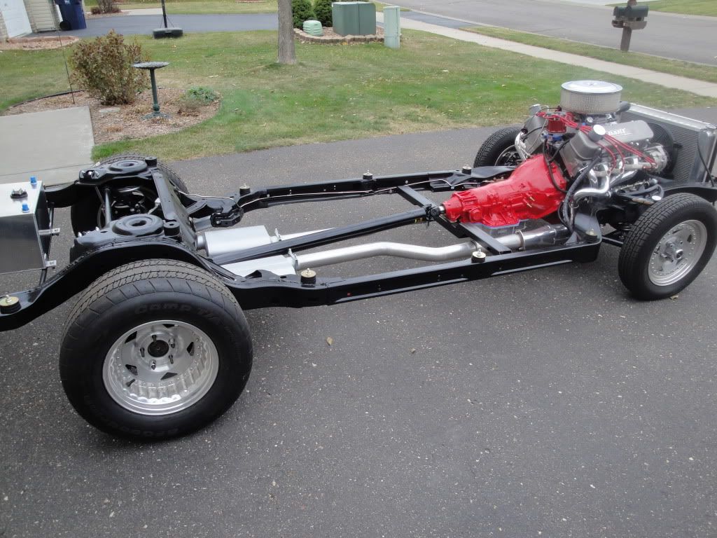

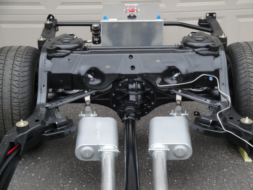

My opinion of POR15 is after application it looks too shiny and gives the impression it is really thick and "goopy". I used Eastwood Extreme Chassis black with the recommended primer and I am really happy with it. Sure it is rattle can but it has the right sheen to it and in the process of putting my car back together appears to be a very hard durable paint. I have nothing against powdercoating but my biggest concern about powdercoating is what would happen if it did chip or flake off. How do you "touch that up"? At least with paint I have the option of masking the car off and touching things up. Here is a pic of my frame. I am on the final stretch of a frame off and stripped my frame down to nothing, had it sandblasted and then I painted it. I started with a frame I purchased from Desert Valley Auto parts that was 1001% rust free.
