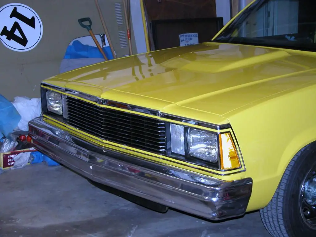

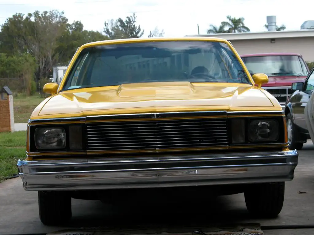

I did it but it's not a direct fit. The Buick turbo hood will fit in the opening. You will need to do some creative bodywork to the header because not only do the body lines not line up exactly but the hood will sit higher in the center and back a little compared to a stock hood. Then rear corners have to be massaged a bit also to line up with the fenders by the windshield. I used fiberglass to modify my header panel.
