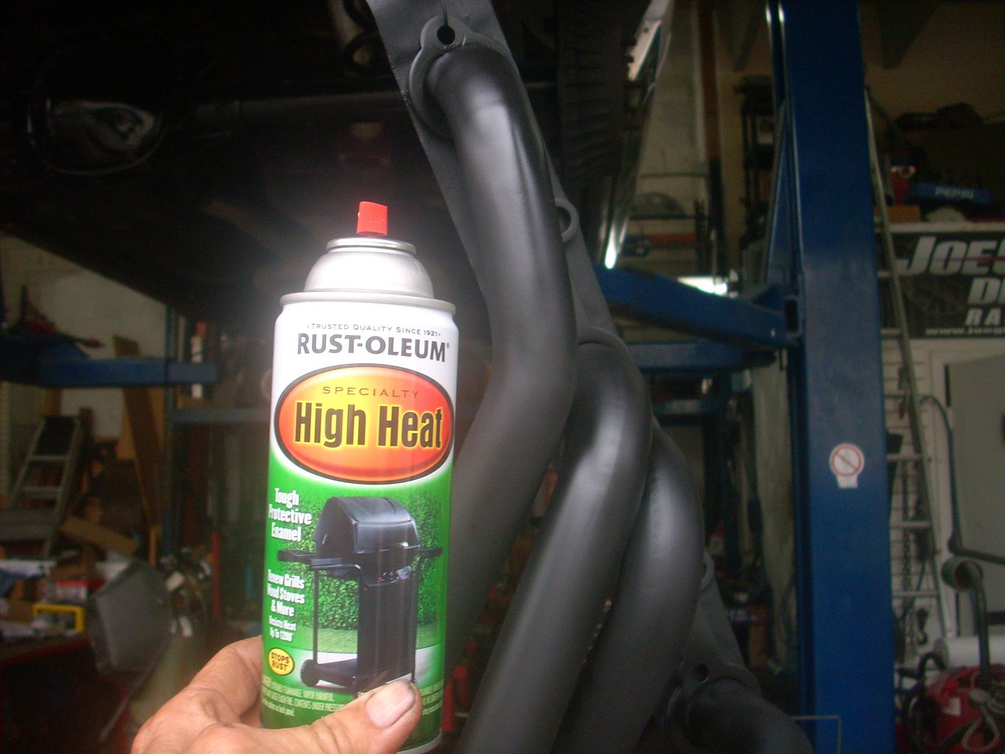

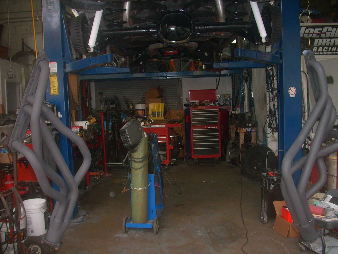

I've been building an 83 Monte the past couple weeks and saw this thread before work today. Today happened to be header day among other things. Wire wheeled all the rust and shot them with Rustoleum BBQ flavor. After a couple hours of drying time installed them. Will go over them with wax & grease remover Mon. to clean up the oil I got on them installing. Takes 2 cans and I let the first coat dry about 1/2 hour before applying the 2nd.
First coat
While 2nd coat was drying
Installed
