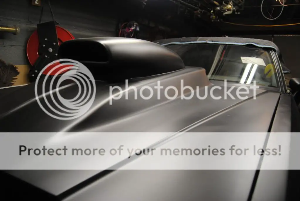

Ive added scoops of plastic and fiberglass to steel hoods and fiberglass to fiberglass and find the best way to do it is a few small rivets then fiberglass resin and cloth, several layers starting small and widening with each new layer. Then some sanding followed by some fiberglass filler to get it all smooth and lots of tedious hand sanding. May be the hardest way but it will last forever. I lift my hood on and off the car now using the scoop as my handel . I installed it using this method.Image

as you can see in the pic it still needs some sanding to get out that bump . thats why I sprayed it black it makes every improfection show up.

That's the way we have done them jmerc. The only one we have had a problem with was one we built on saw horses. After we put the hood on the car it had it in a bind and it cracked over time. (it was sagging while on the saw horses.)
* this was a glass to glass bond
