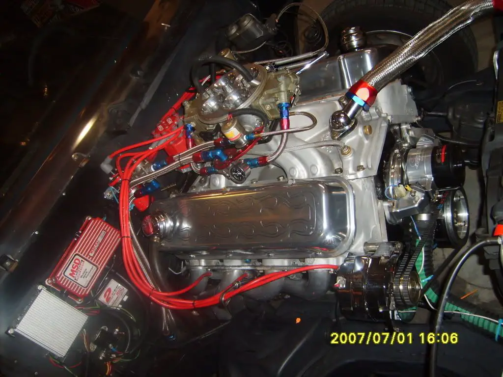

I used a simple setup
I used a 3/4 inch steel spacer bolted it to the head and had to cut a small notch at the top of the lower hose where it goes onto the pump to clear the belt Ill take better pics when I get a chance and show you all the details up close.
