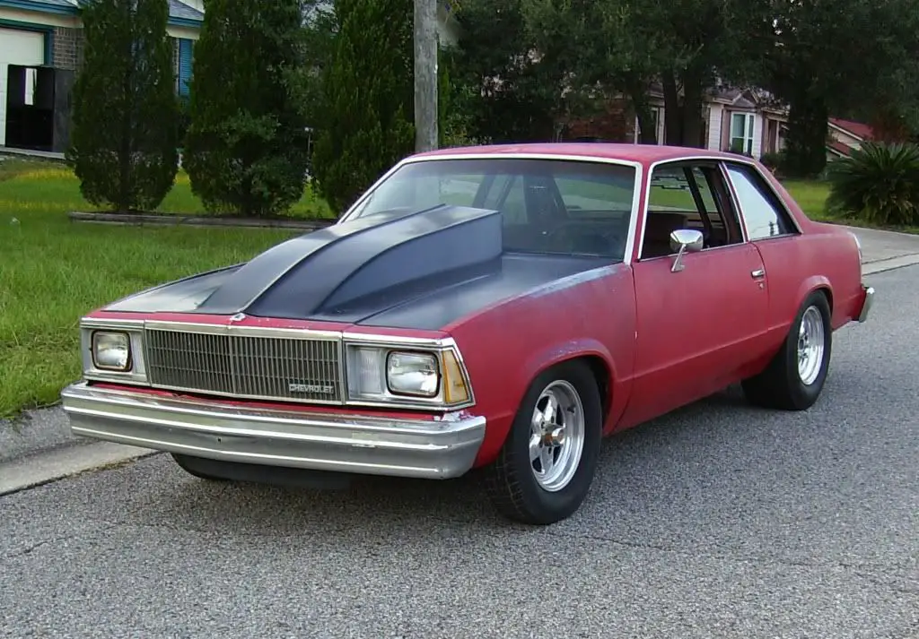

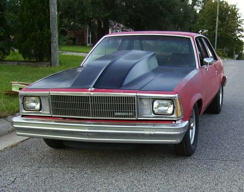

Was running 70 Chevelle 12bolt , max frame notch and bracing, mini-tub, modified fender lips, Weld ProStar 15x10 7.5" bs , M/T ET Street 28x12.50 fit very nice and sat low and tucked.
